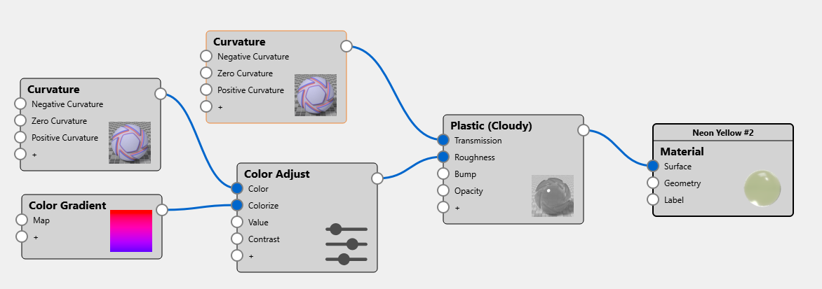

I am trying to create a neon glowing fluorescent plastic material and I am struggling to get that edge glow effect in material only.
Example:
right now I am using a plastic (Cloudy) with a Curvature and a gradient set to viewing distance to affect the Roughness. I am struggling on the wide variety of see through little bit of green to the very vibrant on the edges of the cup.
Example:

I did take another crack at it and I used curvature to get the edges and used different shades of green from that as the Color Transmision.
Super fake and not perfect but easy to tweak, very simple single material.
